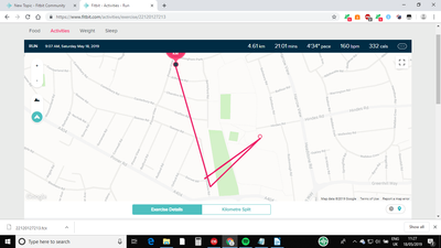

Hi, I've been getting odd-looking runs for 3-4 weeks now with my Charge 2. It looks like the GPS signal is gained very infrequently but it also incorrectly logs me as being in nearby streets.
That's me doing the local Parkrun earlier, for example.
I spoke with Live Chat a fortnight ago, who basically concluded it was a known issue (case number 30135508) which was being worked on but without a resolution date. So yes have manually reset the Fitbit (many times) via a connection to the laptop, but to no effect.
Any advice please?

Best AnswerThanks for the reply RicardoFitbit; apologies for the delay from me, have been away and also missed the email that was sent to inform me of a reply. In answer:
Can you please let me know the specific model and which platform you're using to sync your device? It's a Charge 2 and am using a Moto G6.
Also, how many times you experienced this situation? Have experienced this on every run since the 1st May.
@RicardoFitbit wrote:Please note that all GPS devices, whether your phone or a Fitbit device, require a direct path to the satellites
This is correct, but this isn't the problem here. I get the same poor zigzag tracking with version 2.94 - but I get totally accurate tracking with version 2.91 for exactly the same track.
The solution to the problem to stick to, or to install 2.91 and wait till a working version comes out.
