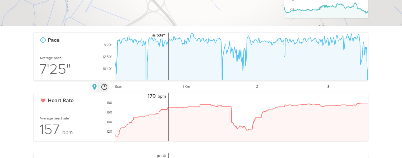

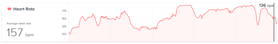

1) The max that I've seen is around 192. I frequently double check these numbers during and immediately after my workout - both by manual checking HR and by using treadmill/bike sensors - so I'm fairly certain I have accurate readings. Graphs from some of my higher heart rate workouts are shown below. Especially in the first image, you can see that my heart rate was above 175 for the better part of 20 minutes or so.
2) How many times has this happened? If it was just once that you remember a higher HR than what your logs show, there could be many different factors that caused that. It's also possible that your HR only jumped to the 170s for a few seconds then went back down. That big of change in a short period of time during high intensity workouts could be missed.
3) Make sure that you're wiping your HR sensor off after every workout. I typically get a damp rag and do a quick wipe down, then dry it off every day. When I first got my Fitbit I went about a week without trying to clean it at all and after a few days, my sensor showed a flat line every so often too. After cleaning it once, it worked nearly perfect. The only time I have issues now is if I sweat a lot more than normal. I keep a towel on hand during my workout and just run it between my Fitbit and wrist if I'm ever unable to get a HR. And same as @cvearl, I wear mine about 1 finger above the wrist bone 24/7, whether I'm working out or doing day to day activities. It seems to work well for me right there.

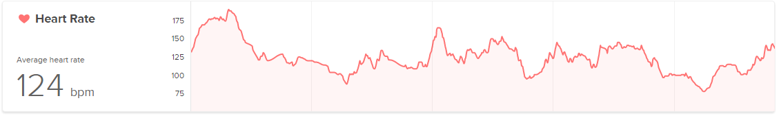

This run was on the 14th of march with the new update.
Its a tad better but still a bit flat at times.
@HybridHayley Were you running during that entire workout or did you slow down/stop for a bit in the middle?
There is an interval stop right in the middle in which part way through my heart rate does a sudden drop.
