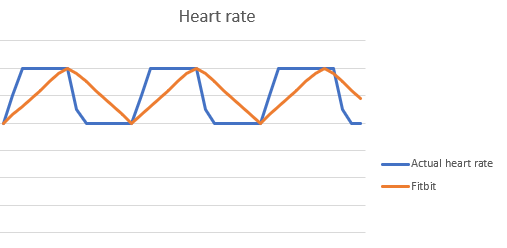

I have similar experience when doing interval training in the gym, based on heart rate. I will have 2 minutes interval - 2 minutes low bpm followed by 2 minutes high bpm, and so forth. To reach high bpm it takes me about 30 seconds to reach and the same for dropping to low bpm. This means that I will will stay on high bpm for around one and a half minute, and the same for low bpm. The curve will be flat - up -flat - down flat etc (see attached graph)
Measurement from Fitbit (when looking at the Fitbit graph) is different. It will slowly show an increase in bpm and after the 2 minutes on high bpm Fitbit will have a correct reading, same when I drop to low bpm - actual bpm and Fitbit reading will again be the same after the two minutes, see graph.
So instead of having a square graph - Fitbit will register a serrated graph.
When out jogging I don't have this problem as my heart rate will be more stable over time and will mostly show a correct hear-rate.
I have tried moving my C3 to different positions at my wrist, I have the unit closer / less close to my skin, but with the same result. I have kept my arm still for more than 10 sec etc.
