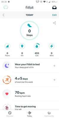

Dashboard:

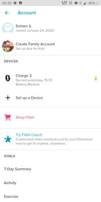

After clicking the account icon:

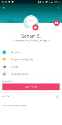

Again clicking the account icon:
As you can see there is no gear icon. I am using an android device.
