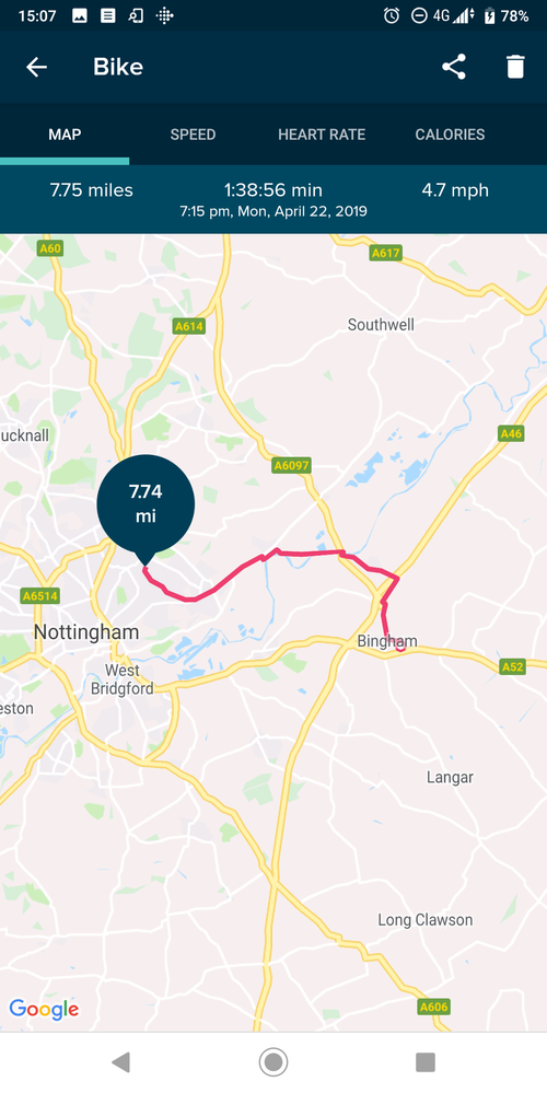

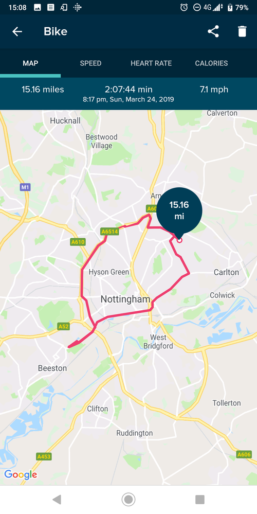

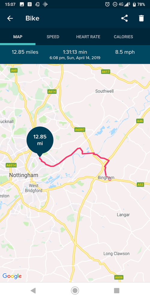

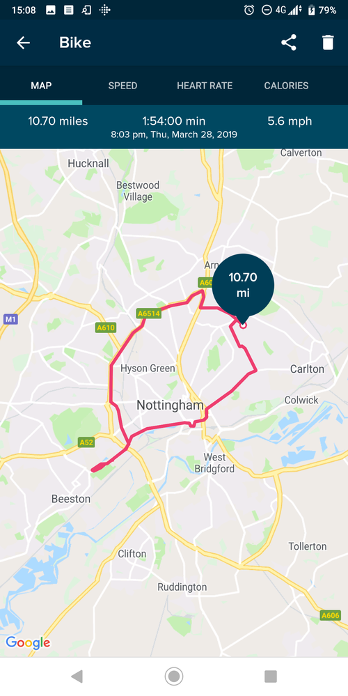

When tracking my cycle rides with GPS the distance is no where near accurate, can be off up to 30-50%. I've tried all the fixes in help forums such as turning on /off, uninstall and reinstalling app, hard reset of fitbit device, reconnecting Bluetooth etc
My GPS is high accuracy, not using WiFi, nothing is blocking signal on my route... Google maps logs a very accurate route and distance of my location so my phone tracking must be OK, however on fitbit the distance is totally wrong, but the route it shows on the map is correct.
