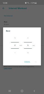

If I'm trying to edit the interval timer rest times on my Charge 4, the rest time can no longer be deleted and I cannot set the time to under 10 seconds. This is very inconvenient as many of my workouts involve 5 seconds rest.
It used to work, but now it doesn't work and I'm not sure why this started happening. I've tried everything (updating the app, rebooting my Charge 4, re-pairing my Charge 4, deleting and re-installing the Fitbit app, logging out then back in, restarting my phone). This is really inconvenient as I use my Fitbit mainly for interval workouts. Please help!

@AlejandraFitbit I have a Samsung Galaxy S10e, so also Android. Attached is a screenshot of what I see when I try and set the rest time to anything below 10s. As you can see, the option to press "OK" is unavailable. Its strange, because I used to be able to set the rest time to 5 seconds and now I havent been able to

Thanks for getting back and for the screenshot, @msysverms.
I just wanted to let you know that I have escalated this to our team, and once I have more information about it I will be glad to share it with you. Your patience and understanding will be much appreciated.

Hello @SunsetRunner and welcome to the Community. I'm not sure why the moderator was able to change the settings 2020 when other users couldn't. I looked at my Charge 4 interval settings options on the iOS app and the web dashboard. The web dashboard has a note in red letters saying that an interval has a 10 second minimum. My only suggestion is for you to share your request in the Product Feedback forum. Fitbit used to call it the Feature Suggestion forum.
