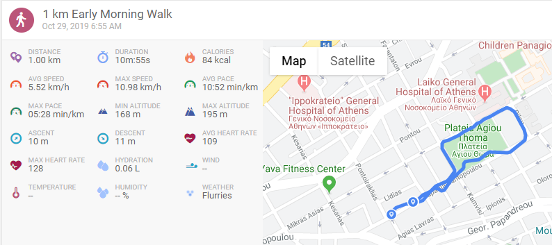

Hi there.
Just tested Android version 3.9 with my Samsung Galaxy S7.
I tracked a 1 KM walk with my Inspire HR and at the same time I tracked the activity with the Endomondo Android app on my phone.
When Endomondo showed that I had walked 1 KM, the Inspire HR was showing 0.84 KM.
When Inspire HR showed 1KM, Endomondo showed 1.2 KM.
Here are some screenshots with interesting results. I don't really know what to make out of this data.
1) Walk tracked by my phone's Endomondo Android app. It shows 1.2 KM
2) The same walk tracked by Inspire HR (using my phone's connected GPS) and automatically uploaded to Endomondo. It shows 1 KM
3) Strava shows 1KM with the data synced from Fitbit
4) Fitbit app shows the walk as 1 KM
@LostEchoes
Would you try something for me?
Go to the Strava website (not the app but the website in a browser). Open the exercise and then in the top right of the screen click "distance", then choose "correct GPS". What distance does it show then?
@SunsetRunner
I did what you suggested.
Now it has corrected the distance to 0.99 KM
