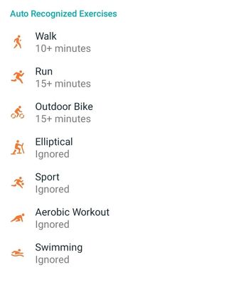

Let's open the fitbit app, tap the exercise tile, now tap the settings cog. These ere the exercises that your tracker can detect.
Walk
Run
Outdoor Biie
Elliptical
Sport
Aerobic
Swimming
Simply because the tracker does not know what arm movements to look for, Downhill skiing will not be auto detected.
Yes weight training is not on the list, neither is running on a treadmill,

I just checked, yoga is not one of the auto detectable exercises. True each exercise has a setting that can be adjusted.
