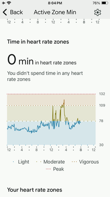

my inspire HR tracker is not recording zone minutes. It tells me I have done zero many minutes in various cardio zones while the graph right below. It shows that I’ve been doing anything from moderate to vigorous. I’m gonna try to include an image of this so you can see exactly what I mean.
This problem began with the shift to Google. I would appreciate any insight advice that kind of thing.

@Sally203 According to the Inspire HR manual, that model gives active minutes, not active zone minutes. Please tap on the pencil icon in the upper right of your Fitbit app and make sure Active minutes is toggled on. I looked at your public profile and saw that you have used other models, ones that give AZMs. Sometimes the app will show the AZM toggle, even though your current device doesn't support it.

That makes sense. I have both active and active zone toggled. I will see what happens when I takeoff the active zone minutes toggle. if you’re right then no graph will appear at all. Thanks
