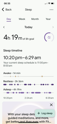

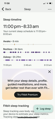

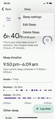

Did this work? I have a big difference between the app start sleep now and when I add it manually (which is definitely more accurate).
this is app
this is manually added and much more accurate.
app has added an extra repeat sleep between 1020 pm and 0159 and put sleep on for 9.50pm to 0609 ????
