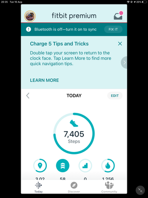

Hi, @SunsetRunner apologies for the delay in responding.  I have now tried the experiment twice: using my Charge 5 for part of the day and then switching to Inspire 2 for the rest of the day and checking my steps.

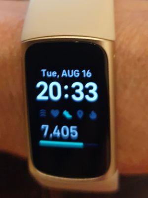

I did not lose any steps either day.  I’ll share some photos I took.  Here is the Charge 5, showing my steps up until the switchover.

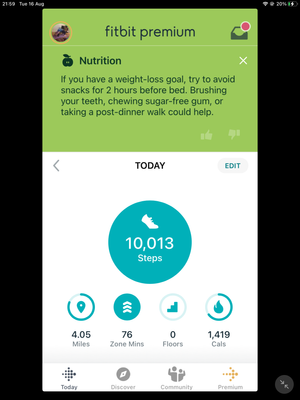

Next, I synced the Charge 5.  Here’s my app showing the steps.

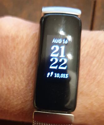

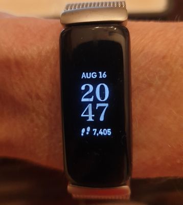

Once it was synced, I set up my Inspire 2 and I synced it to make sure it showed the steps from my app.  I did not go anywhere.  I had them both together to make sure the numbers matched - the app and both Fitbits showed the correct number of steps. (Sorry - I should have tried to get a picture of all 3, but you get the idea. ).  Here is the Inspire 2 showing the same steps as the Charge 5 and the app.
With Inspire 2 all set up and synced, showing same steps as Charge 5, I went out for a walk, and came home with more steps.
The last step was to sync my Inspire 2.  Here’s a photo of my app showing that no steps were lost in the switch between the Fitbits
