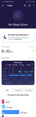

I'm having a similar problem - my tracker stopped giving me sleep scores and when I went to check my heart rate function can see it's no longer tracking.  Reset did not fix the problem 😞

Same here! My data is messed up cause my bpm isn’t working, so my sleep data is all wrong.

My hubby and I didn't get sleep scores, because there wasn't enough data. No restoration (heart rate) recorded.
