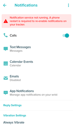

I have not been receiving notifications from apps or my messages on my Inspire HR. Calls go through normally but no app or messaging platform notifications show up at all. It says my notification service is not working in the settings and I have tried many ways to fix it. I have restarted my phone multiple times, my Inspire HR multiple times, unpaired and repaired both the phone and the Fitbit, and resynced it multiple times, all to no avail.

My phone is a Samsung Galaxy J7 Sky Pro and the first time I experienced issues with notifications on my Inspire HR was about a month ago when I used the Do Not Disturb function on my phone for a test. Afterwards, I turned off Do Not Disturb and my Fitbit no longer received notifications from messaging services or messaging apps. The Fitbit App told me that my notification service was not running and a phone restart was needed to get the service running again, but calls still showed up on my Inspire HR. I will try some of these troubleshooting tips again and see if it works.

I uninstalled and reinstalled the Fitbit app, now my notification settings have been fixed. I now get notifications on my Inspire HR again.
