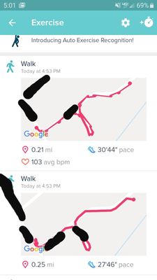

Take a close look at your map and zoom in.  Does the path zig zag rather than follow your actual run?
I'm new to Fitbit and finding similar complains about connected gps accuracy.  All the zig zags add distance and mess up the distance and pace readings.

I'm Android as well.  Most of the forum messages are under other Fitbit models but have lots of reading with various tricks that don't yield a solution.  Apparently this is a new issue that started in the last year or so with no official acknowledgement of the issue.  I've tried them all and even completely factory reset my phone.  Screenshot attached has a short walk recorded at the same time From the Fitbit (top) vs. directly within the Fitbit app (bottom).  All those zig zags throw off the distance and pace stats particularly on a longer exercise.
It shows I've got good gps signal and the phone can plot a smooth path.  Something is getting lost in how the tracker communicates.
