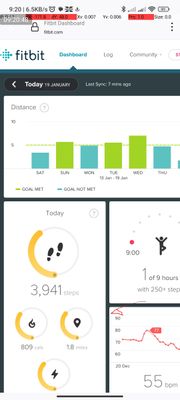

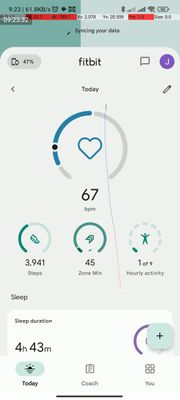

Attached screen shot of usual interface with sync in progress as shown at top edge after pull down.
And the dashboard which probably shows similar info but I've only just now discovered that

The dashboard I provided a screenshot of in my last reply to self is a new discovery for me this morning, & I won't have time to explore it Today.
