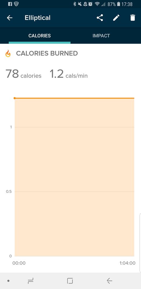

I was on the Elliptical at my gym for an hour plus a five minute cooldown.   My Versa recognizes that I did that, but it tells me I burned 78 calories.  No typo.  78 calories.  O would burn more calories standind still.  What the hell?  It won't even let me edit it to show the closer to 780 it would be.

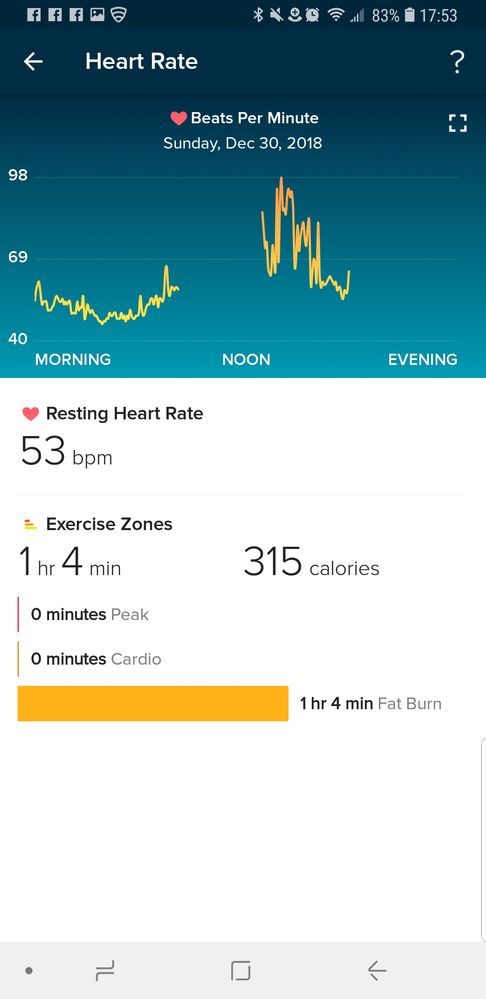

@Baller1967 Can you please share screenshots of this workout? I am particularly interested in heart rate recording and calories-burned charts.

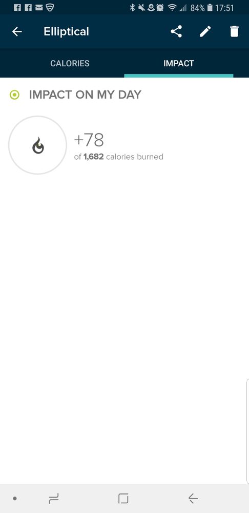

@Baller1967 how about heart rate and impact? Thx!

@Baller1967 did this exercise take place around noon? before noon? There's a huge Heart rate recording gap, and I do not see heart rate tab in your workout. It leads me to believe HR was not recorded and that's the reason for the fail.
ETA: Go to Settings on your Versa, scroll down to Heart Rate and toggle ON and OFF with a reboot of the tracker in-between. To reboot your tracker, press and hold the left and bottom right buttons until Fitbit logo flashes. A few additional tips: adjust your Versa's band - wear it more tightly or higher. Also, if you sweat a lot, you may have to wipe the sweat from your skin from time to time.

It was around 11:15 this morning.  When I'd check my wrist to see if it was matching the machine's HR, it was usually giving me a "--" reading. The ellipitical summary afterwards said my average bpm was 135 and the peak was 147.
@Baller1967 Yeap. Versa didn't read the HR. Please do what I recommended and report back!
