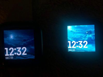

I just posted a similar question. Compared to my original Versa, this display sucks. It doesn’t come close to the brightness of my original Versa and the display quality even is worse. Here is the av 2 on the left, original on the right. Both are at 100% charge and both set to MAX brightness.
