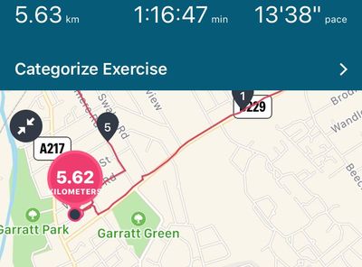

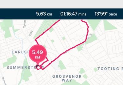

Same issues here. I love Fitbit as a platform and was going to buy an Ionic but think Apple is the way to go unless this is fixed quick. I look at my Versa as i'm running and think i've done 5K but it reports 4.93. This is a walk I did today:
From the app:
From the web:
