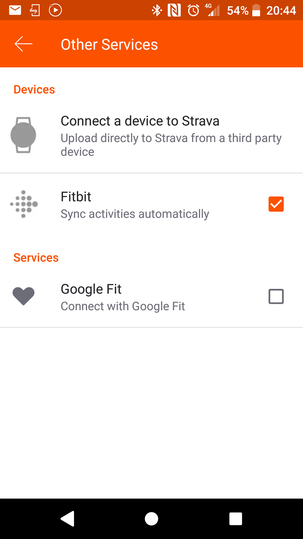

So, as above? Never had to anything on the fitbit side once it's connected.

Iphone go to settings.
Scroll down to your app listings until you locate then select & open Fitbit.
Option - Location - select always.
I too have Bluetooth sharing, mobile data & back ground refresh enabled.
Strava. Location is set to: While Using.
If still not connecting delete FitBit App & reinstall. If that fails Start from scratch - rest Versa, delete reinstall app & set versa as up again. Don't worry you will not lose any workout data. All will be there when you log back in.
