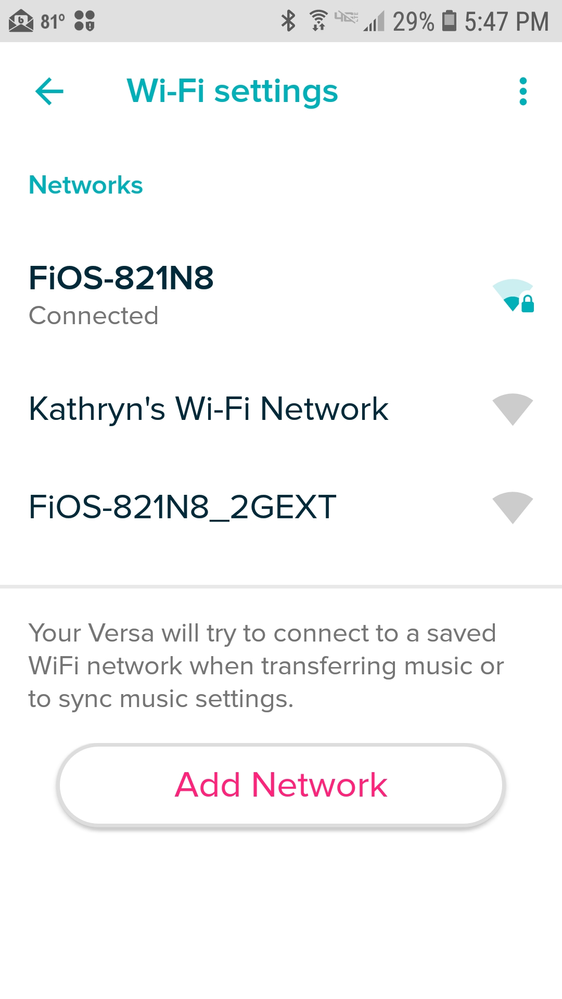

@runningmufin98  Can you confirm that your Versa is connected to your WiFi?  You should see this screen in the Fitbit app.  It needs to say "connected" by the 2.4 gHz band name.  I have to go in and make the connection fresh to do it.  Also, on my Versa in Settings>About, if you scroll down to WiFi you need to see the IP address listed there.  Mine will initially say WiFi not connected until I refresh that connection in the Fitbit mobile app.  Also, of course, it needs to be the same network as you computer is connected to.  You say your WiFi is 2 or above.  But, a WiFi connection band of 5 gHz won't connect.  So, it needs to be the 2.4 gHz band of your network.  Once you have all that open the Fitbit Connect app on your computer and you start the Music Transfer from the Versa.  The computer will indicate it's looking for your watch.  It should then (mine take about a minute or two) to actually find your Versa to allow the transfer.  You'll want to have a playlist made of songs specifically for this transfer.  Don't do song by song.  Also, a place where people often get stuck is that you have to actually OWN the music you are transferring.  Music that you downloaded through a streaming service for which you have a paid subscription is only "borrowed" not "owned".  You paid for the rights to borrow the music as long as your subscription service is current.  This is a music industry limitation and not something specific to Fitbit.Wifi Fitbit.png
