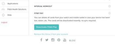

How do you turn off Fitbit pay. That's the problem.

Let’s try another route @Gabe8
Tap the dashboard button at the top of your screen then tap the gear icon to the upper right of your screen and tap Versa 3 in the drop down menu. Now scroll down to the bottom of the Versa 3 information and tap “deactivate Fitbit pay” then tap submit. Sync your Fitbit to accept the changes.
