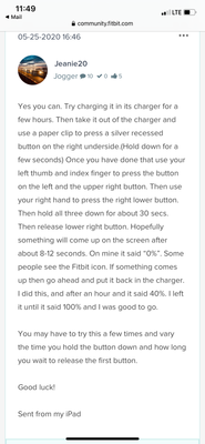

It’s working again! I did a lot of searching on these forums and found a solution that brought mine back to life. The sleep function is acting wonky but everything else is working. It’s worth a try. Not sure why multiple people from support didn’t say anything about trying to press the tiny button on the underside of the watch that I didn’t know even existed...

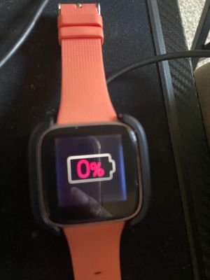

I left it on the charger overnight hoping it just needed a long charge, but nope. I unplugged it and put it back on again and it showed an icon of a battery with 0% after being on the charger for 12+ hours. Very disappointing!

This is the only thing it does now.
This worked for me and I am so relieved!! Thank you for posting!!!
THANK YOU!! This worked for me. I was already brooding about spending $200 on another one.
Someone told me to hold all three buttons and that worked for me !
