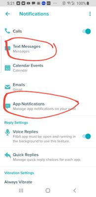

Is textra an option under the fitbit notification / text messaging or do you have to look under the app notification.

I am a person and still would like to know where in the settings that the Textra app was chosen?
Where you able to set it up through text messages, or did you have to go through the App notifications?
I'm asking because i do not know if Textra was registered properly as a messaging app in the phones OS.

Figured it out by changing the Android heads up buttons in Textra. Seems to work now.

@CodyP2112 that makes sense, since the Heads up controls popups which is needed for Fitbit to intercept the notification.
If a user doesn't see the notification while the phones screen is locked. Fitbit can not send the notification on to the tracker.

I followed the instructions in this thread
