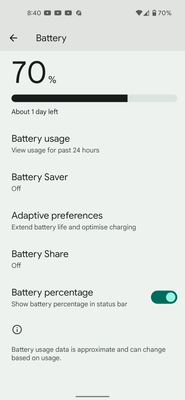

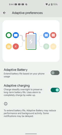

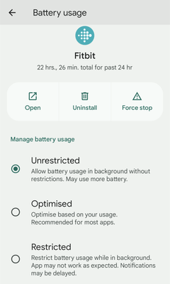

Hi  @MarkMori - thanks, did you check your battery saving settings on the phone? If the phone puts the Fitbit App or Bluetooth to sleep then that could be a problem.
It's always off on my phone
I'm turning off adaptive preference, but at this point I'll say you need to fix the Fitbit app.
