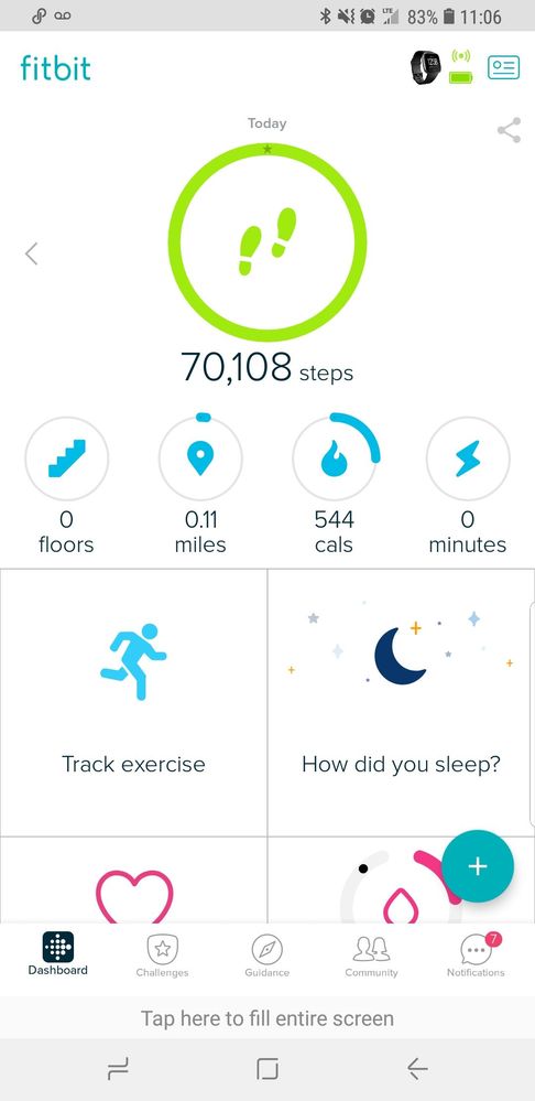

Same! My versa has been on the charger since last night and this morning I woke to already having 70k steps in Screenshot_20180730-110656_Fitbit.jpg
