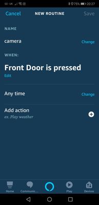

As some of us know that we can not get Ring Camer App notifications to get pushed to the Versa 2. I have called tech support and they all are aware of it and working on it. In the meantime, I found a workaround by using the Alexa app. In the Alexa app add your cameras to the app under devices. Under routines add a new routine click on the following order listed below the only caveat is you will get two notifications one from the ring app that only shows up on your phone and not your device. Plus Alexa pushing a notification to the watch and the phone. Make sure under the Fitbit app that you have selected to receive notifications from Alexa
  • when this happens
  • device
  • your camera
  • motion
  • select detected
  • next
  • add action
  • messaging
  • notifications
  • Enter your message
  • next and save or edit the anytime to your schedule

 what do I select when it says add action. As it won't let me save it until I have one of those
Add the notification

Add action then tap on messaging then notification then add your custom notification and then save it . Sorry I have been away from the forums for awhile
