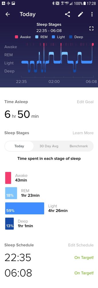

Though the application doesn't seem to tell you how long you took to fall asleep, here are some screenshots to show you what the sleep insight looks like.
This first one is the overview (I've only had this since Monday night so I've only got 3 sleep sessions):sleep_overview.jpg
The next is a detailed view of last night's sleep:sleep_detail.jpg

This sleep intel looks amazing! How do I see that on my versa or in the app? I can’t seem to find 😞  The settings seem so limited on the versa unless I’m missing something 😕
All the intel is available in the app. Just tap on the sleep tile and then scroll down to tap open the seperate days. There you can see your sleep phases and can compare your nightly data with your own average data and your age group's avarage. (It's interesting how much being awake is considered normal...).
Also, if you touch on the graphic to zoom in, you can find information on the meaning of the different sleep phases.
So, just play around with the Fitbit app on your phone a little! There's lots of nice little details hidden that you don't see immediately.
