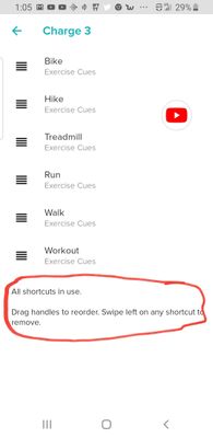

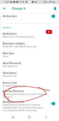

Here you go
If all slots are full you will see this message

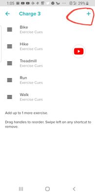

Swipe an exercise off the screen and you will see a plus sign.

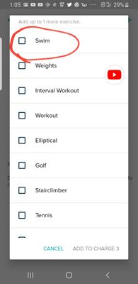

Now check off Swim
Really appreciate that you’re trying to help. But I have the Versa Lite, not the Charge 3 that your example shows. There is no option to add swimming. Thanks anyway.
