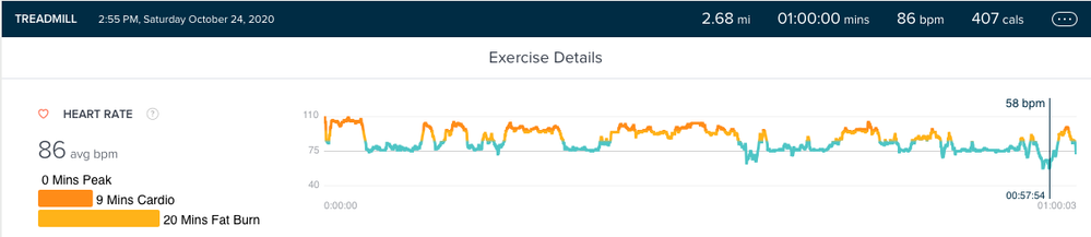

And just today - does anyone think that a 68-year old man with a viral damaged heart is going to be at 58 bpm at the end of an hour on the treadmill at nearly 3 mph? Not to mention all of the other dips.

After a little over two weeks, and the first two days with my Versa alongside it, my Apple Watch Series 6 has shown only one weird spike at the first seconds of a rowing machine session.
With two one-hour treadmill sessions a day for a total of 24 sessions I only had a reported maximum bpm for the session over 100 bpm seven times, topping out at 112. for the first week, I was manually checking my heart rate against the Series 6 at least six times each session and still check it a couple times now. Never was the variance more than 2 bpm which is probably because I am averaging over 15 seconds and the watch is realtime.
With my taking Beta Blockers my cardiologist states that I shouldn't expect to go over 110 except rarely and, in fact, doesn't want me to. And definitely not the 140 - 156 range my Versa 2 often reported - it is just impossible as Beta Blockers block the effects of the hormone epinephrine, also known as adrenaline.
During the parallel testing, the Versa 2 was consistently 8 to 15 bpm higher than actual and often as much as 24 bpm higher. Rarely was is the same as my manual check or the pulse-oximeter I use.
For all of you still with the Versa I can only hope that the latest firmware update helps.
And yes, the Versa 2 is not a medical device. Neither is my Apple Watch. But as a fitness device, my Versa 2 was a failure.
