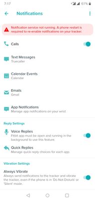

I have already done all this. But the watch show notification server not available restart you phone and try again.
Your reply is appreciated @Batth
To further investigate and better assist you, can you please send me a screenshot of the error message that are you receiving? It seems that the message described in your post is about the notifications feature of your device but I'd like to make sure so we can move on.
I'll be waiting for your reply.
Thanks for your reply @Batth and for the information that was shared with me.
Based on the screenshot that was attached into your post, the issue you're experiencing is with the notifications feature of your device and not syncing it, am I correct? Such error message is usually shown when the Fitbit is connected to a non-compatible phone and therefore, the notifications feature may be compromised. That said, can you please specify which phone are you using? In the meantime I receive your answer, I recommend you to check: How do I get notifications from my phone on my Fitbit device? to see that all the necessary requirements to receive notifications on your Versa 2 are correctly configured and to try some troubleshooting steps.
Thank you for your kind help. I am using OnePlus 6 Android version 10. I am already done all this things. But no use. Versa2 was ok till that time before my phone is not updated. When my phone getting updated at that time it stop working.

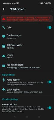

 I am not getting any notifications on my watch. Phone model Redmi 10T  5G.
I am not getting any notifications. My phone is REDMI 10T 5G
