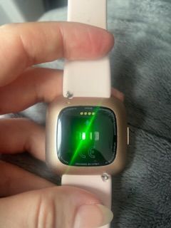

I meant to include a photo of the back of the Fitbit. Only one of the sensors (of 4) is lighting up. I can’t recall if this is normal or not.
Best Answer02-18-2023 06:20
02-18-2023 06:20
Only one of the sensors on the back of my Versa 2 is lit. I've a slightly different problem to the OPs which has it's own thread (no screen at all at the moment) but I'd also like to know if only one lit sensor may be a clue to anything.
