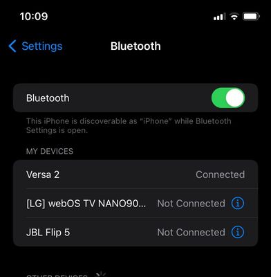

My phone is the only device connected to my Fitbit via Bluetooth. I also have an iPhone, not an Android. I tried to Forget This Device and follow those instructions but it wouldn't allow me to, it just kept Versa 2 connected without the (i) and option to disconnect it. I turned off Bluetooth, followed those steps, and it didn't work still.

Unfortunately, my phone literally will not give me the option to unpair. If I turn Bluetooth off and on again, it automatically repairs and doesn’t give the option to forget this device.

@EmmaKuhnsman - thanks for the photo, it might give you the possibility if you logout of the Fitbit App and turn off the watch from the watch Settings About menu.

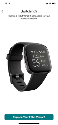

@EmmaKuhnsman- since you restarted both watch and phone, try in the Fitbit App click profile photo and "+ Set up a Device".
If this fails see What should I do if I lose my Fitbit device? This may tell you if the watch has stopped transmitting a Bluetooth signal.
06-11-2023 02:14
06-11-2023 02:14
Will this lose all my data if I replace it, even if it’s replaced by the same watch?
06-11-2023 02:20
06-11-2023 02:20
@EmmaKuhnsman- the data is held on the account, replacing the watch merely changes where the account gets it's source data from. It should setup Bluetooth and can install the watch firmware if not already installed. Data on the watch not already synced may be lost if a new firmware is installed but the data already on the account remains intact. In your case it shouldn't install firmware, unless you factory reset it.

Alright thank you! That worked!
