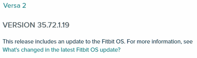

What does your wrist say your firmware version is?
35.72.1.19
See What's changed in the latest Fitbit device update?
You have the latest firmware.  This doesn't solve your problem, but my advise is to forget about the perceived update failure, and focus on what is causing your shortened battery life.
