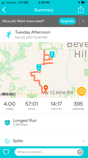

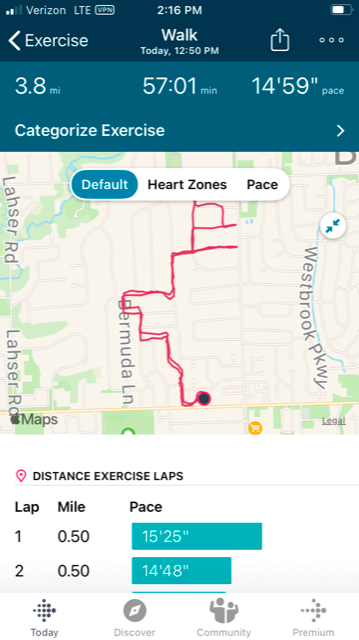

Hi RicardoFitbit, I really do hate flushing money down the toilet, but here is from today, GPS went out again, nothing but blue clear skies above.  I also downloaded RunKeeper, which amazingly comes in with the exact same distance as my Versa 2 would log.  Is there anyone at Fitbit to actually talk about the possibility that the GPS in this watch is not functioning properly???  The chat is usless, they simply review articles and tell me that it isn't calculating correctly because I'm inside or around tall buildings.IMG_0505.jpgIMG_0506.PNGIMG_0507.PNG
