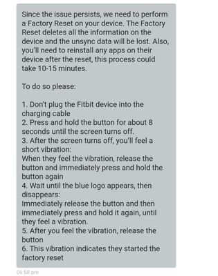

I was doing the new update. It got to 10 to 12, when the screen froze with the fitbit logo. I've tried everything mentioned in previous comments but my fitbit can't connect to my phone. Bluetooth is not finding it.
I've restarted as it says, Fitbit logo disappears, vibrates once, then logo appears again and is still frozen.
It's getting very frustrating!!

Mine is fixed now. It working again by doing factory reset.

I've done the factory reset. Now my screen is blank. Vibrates when I press button but nothing else???

Just keep on pressing the button until the fitbit logo appears again. Thats what i did.

Finally up and running. Thanks for tip on keep pressing button. Now I've just got to set it up again.
