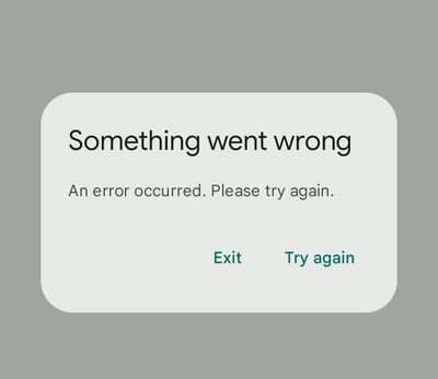

This is happening to me with my Versa 2 as well. The last app notification I have is from Tuesday. After that it stopped syncing. I tried all sorts of troubleshooting including uninstalling and reinstalling Fitbit. When I disconnected and tried to reconnect my Versa 2, it tells me "Something went wrong"
if this is an issue with the latest update, I hope they fix it soon
