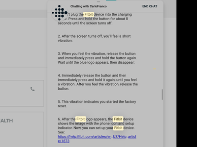

FitBit support provided these instructions to do a reset to factory settings. It might work. Didn’t work for my first Versa 3, it did work for my replacement Versa 3 when it did the same thing. You’ll then have to pair your Fitbit with your phone again. You might have to “forget this device” in your Bluetooth settings to do so.
