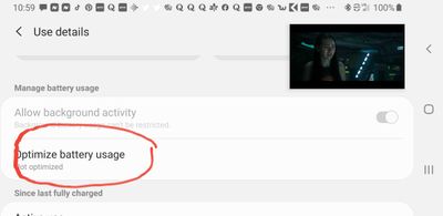

It didn't work without me "waking" the phone several times (although not as often as usual) but, on the bright side, my distance tracker is much more accurate today than it has been.

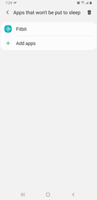

Please also disable power management for Fitbit. Some android phones require this.
 yes I'm also watching YouTube in the popup.
Ok I did that too. Thanks for all your help on this!
If I disable power management I can't restrict background usage.  Does that matter?
With the later android os power management stops the Fitbit app when it gets moved to the background. If the app is asleep gps won't connect
