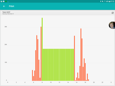

yesterday I watched my Versa's screen change from just over 13,000 steps to just over 8000 steps, with a few screen graphics like fireworks. A reset didn't fix the issue. look at the results screen in the app and it clearly shows a flat line of steps, while in fact I was active.
This has happened to a lesser extent twice in the last month.
Any explanation or suggestion about a fix? The Versa is 13 months old.

I appreciate your participation in the Forums and sharing that you are losing steps. Thank you for your efforts to resolve this and providing a screenshot and the additional details. I would like to confirm if you're manually logging any activities? If so, I recommend confirming that you have the correct time and duration of the activity.

Thank you I got a reply from them that was not an answer at all. It didn't look like they had looked at the original issue at all and I replied to them saying that the answer wasn't satisfactory because they talked about accuracy. It's not a question of accuracy when you see the device lose 5000 steps. I now have a second issue. For at least the last hour the time on my Versa is exactly 19 minutes slow. I had a similar issue back in March when we finished daylight savings - it was slow, I don't recall by how much. At the time I just regarded it as a quirk and didn't worry about it. I have done a reset and nothing changed - it is still exactly 19 minutes slow. for the life of me i don't understand how this can be. and for the record, I look after my fitbit - never in water, always clean, never dropped it. And, as often happens, notifications are not coming through and I am VERY well versed in how to fix that, but that's not working for long at all either.
