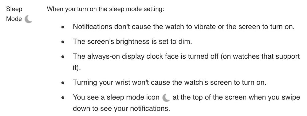

Everyone, please check to make sure your Versa was not inadvertently set to Sleep Mode. From the clock face on your Versa, swipe down. You should see what looks like 2 little paddles at the top, right of the screen. Tap to view the Quick Settings. The little crescent moon is Sleep Settings. Make sure that is set to Off. Hopefully this will resolve the issues.
From the Help Pages:
