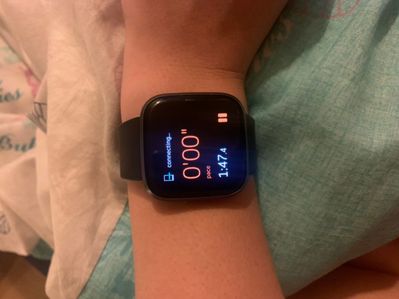

When using the walk exercise tracking setting on my versa 2, usually I connect my phone with my Fitbit and it stays connected for my whole walk. The last few times I have tried to use this as soon as I lock my phone or minimise the app it disconnects. So I’m not getting all the detail on my walk.

I mean minimising the app, as I said. So using another app whilst Fitbit is open in the background or simply locking my phone as I don’t want to be on it whilst I’m walking. I would expect the connection to be lost if I was closing the app but I’m not and it has also only just started doing this and I’m doing nothing different to normal.

Same thing is happening to me Lizzy - it was working fine before, and the app has permission to use location all the time.  It is very annoying!
Why would the setting change on its own though? Also I have an iPhone not android sorry
I have an iphone also.  It did not change in the settings.  I contacted fitbit support and they had me reset my watch by holding down the back button for 10 seconds.  It seems to be working - but I have not run with it yet, I just did this with support.  Maybe it will help you?

Update - the resetting of the watch worked - I ran this morning - it connected to my phone GPS quickly and stayed connected the whole time!  🙂
