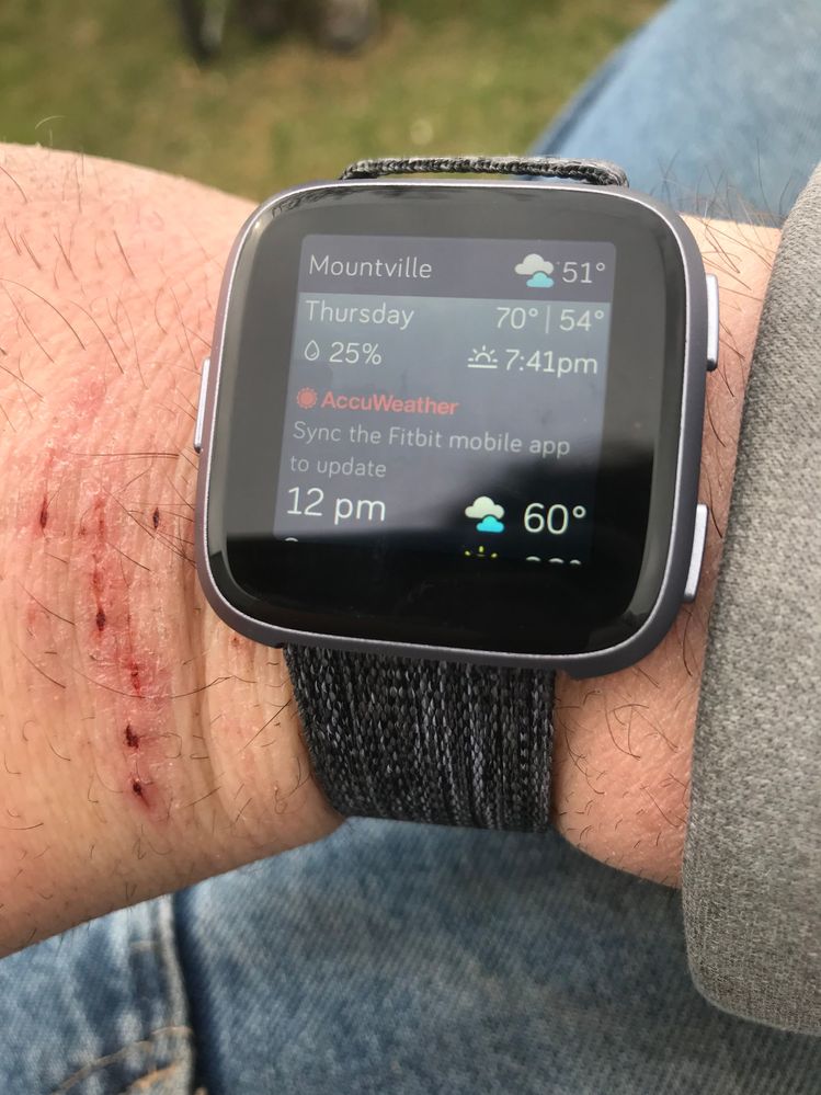

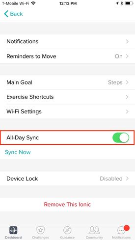

Hi, I have all day sync enabled for my versa, but every time I open the weather app it tells me to sync the Versa with my phone. Shouldn’t it be automatically syncing since I have all day sync enabled? Thanks.

Here’s a picture of what I’m talking about. I don’t want to have to pull out my phone every time I want to check the weather. Anyone know how to fix this? Thanks!

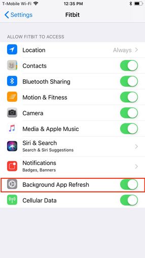

Go to your Fitbit app settings under your phone settings, and set your location services to “always.” It won’t work if it is only turned on while using the app.
