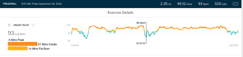

I agree that the Treadmill exercise app has HR issues, though my observations always seem to show a major under-reporting of HR with an occasional over-reporting.
What does anyone think the odds are of my heart rate actually dropping from 109 bpm to 56 bpm in 28 seconds? BTW 104 bpm 90 seconds later.
And I am a 68-year old male with a viral attacked heart from 2017 that only pumps out 25% of the blood from my heart each beat instead of the normal 75%.
And what is not shown are two instances where my heart rate display went blank and the iOS app heart rate panel showed resting heart rate.
While irritating, especially since I reported this flaw over six months ago and the same flaw in the Charge 3 over a year ago, this is not a show-stopper for me. Even the Apple Watch Series 5, routinely rated as having the most accurate heart rate recognition, has documented issues with the heart rate algorithms when in "exercise mode".
Like I said, just irritating.
