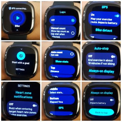

@LizzyFitbit I suggest take one Sense 2 (I'm sure you must have access to one), open Exercise app, go to Bike, open settings and scroll down the options. You will be surprised. But since Fitbit doesn't seem to let emplyees to use the watches, here:
There is auto-stop which isn't the same as auto-pause. Run exercise has auto-pause but doesn't have auto-stop. Please, don't spread misinformation and check before you respond.

Hi there, @t.parker, @Diederick and @gerbir21.
Thanks for getting back with more details and the pictures provided. Let me explain that for the Sense 2 the Auto-Pause function was changed of name to Auto-Stop; however, it'll work the same. This means that your watch will vibrate when you're still to indicate that activity tracking is paused and if no activity is detected for 10 consecutive minutes, your watch will ask you if you want to end the exercise. The Auto-Stop function is available for Run, Bike and Walk, and this information will be updated soon in this help article.

Sorry this is FALSE, I have been having the same issue & have been incontact with a member of the TEAM the Auto-Stop doesn't pause the ride exersice it keeps running. Today on my ride I had to pause at the Traffic Lights & it did not pause but kept running. Your Team instructed me yesterday to reset to Factory settings to fix this but it didn't, I purchased the Sense2 on the 8/12/2022 & the version is 60.20001.184.52.
I'm thinking that your latest update lost this feature in the progaming of the update.
