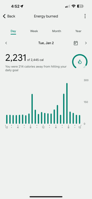

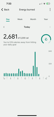

Normally, my calories burned/day varies. But is usually over 2,000 calories, closer to 2,400 on days I exercise. A few days ago, my calories started burning at a standard rate of 60 cal/hour: 1,417/day for 3 days straight. I even logged exercise on these days that show more than 60 cal/hour but my calories still just show that I steadily burned 60 cals every hour. This happened overnight with no apparent cause. Any ideas what’s happening?

I'm guessing that's your BMR (Basal Metabolic Rate) calorie burn. Look at one of your days before this started at calorie burn graph overnight at minimum to see if that was also 60 cal/hour. Check if you are getting any heart rate reading. If not, if might revert to BMR, but I don't see any way to turn off heart rate in Sense 2 settings.

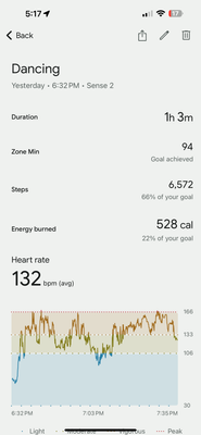

BMR makes sense but I’m definitely getting a heart rate reading. This screenshot is an exercise from the same day my calories logged a standard 60/hr. And if I look at my watch actively, it’s always reading a different and seemingly accurate BPM reading.

And I assume it is syncing so you can look at today's heart rate chart and see it is still not constant, thought I guess above chart proves that.

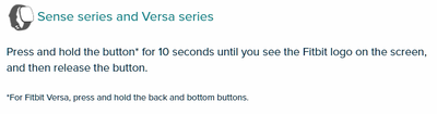

Check your weight, though that wouldn't really make sense, then try a restart .
Don't really expect that to help either, but always good thing to try; never does any harm and sometimes helps.

I am able to sync and the calories on my watch match the calories on the app. I checked my weight and it’s accurate. A reset didn’t change anything unfortunately. It’s just so peculiar. I’ve had many fitbits over the years and have never ran into an issue like this.

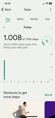

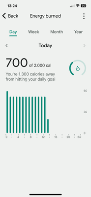

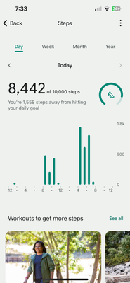

I have the same and in addition no steps logged in the details. Every time calories are showing at standard burn rate, steps/distance is missing too.
last time they properly synchronized was a bit after midnight before I went to sleep. Nothing ever since. Total steps are there, details are missing.
Usually if I reset the watch after a few hours the calories and steps show up. Posted many times about sync issues and had a chat with support on 2 different occasions...no solution.
Do you have steps logged properly?

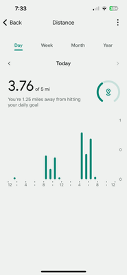

I am also having the same issue.
There are random periods throughout the day where steps, and distance data are missing, and calories data is running at BMR even though I was active during that time.
It has been happening for a few days now. After resetting the watch the missing data usually comes back after a few hours.
Screenshots here showing missing data from today between 12 and 4pm.
I am using an iPhone 13 with iOS 17.2.1
