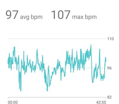

So it would seem, screen shot from Samsung Health vs Fitbit....
Sense 2 is a bad choice for strength training and even for treadmill sessions. Its HR readings are highly inaccurate. This implies everything else that this watch calculates is inaccurate as well. Better to avoid fitbit and look out for alternatives.

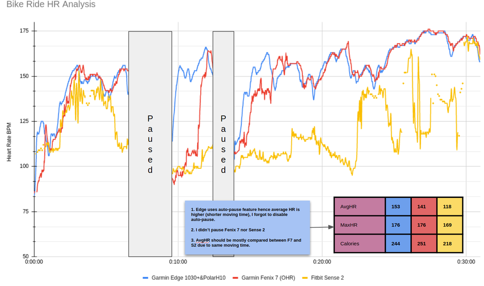

@Maz_Fletch so here you go. Your problem is HR. I could show examples of rubbish HR on Sense 2 every day. A few hours ago my bike ride:
In general, I don't trust wrist heart rate monitors (not necessarily optical because PolarOH1 and the latest Polar Verity Sense are on-par with chest straps but they are not meant to be worn on the wrist). This time I went for a small experiment. I paired my H10 chest strap only with Edge 1030+ and let the Fenix 7 record HR using a wrist sensor. I wasn't expecting impossible and it's well visible I didn't get anything even remotely impressive. Yet still, it follows the chest strap a lot better than Sense 2 (although, for me, this is not enough). I'm a bit lazy to compare only moving times and unfortunately, I forgot to disable auto-pause on the Edge device. Hence, the Edge AvgHR is higher (shorter period of moving time and nearly 100% accuracy). Fenix 7 seems to perform worst right after pauses (or, in the case of both watches, stop and rest periods as they weren't paused like Edge was). However, the majority of the time it catches up with the chest strap (probably "good enough" for calories and AZM but not for any serious training). Sense 2 on the other hand does whatever it wants. There are visible holes which means that it couldn't read my HR at all. I don't expect 100% accuracy when cycling using a wrist sensor. For casual cycling, I guess Fenix 7 did quite a decent...ish job. I would need to either test them together with auto-pause... oh wait, that feature has been taken away on Sense 2 🤣... well, so the only way is not to pause (or never stop). I'll give it a go tomorrow and maybe will add Galaxy Watch 5, although GW5 is a pain when it comes to extracting activity data.
So this is about Sense 2 and HR accuracy - probably the worst sensor in the market.
