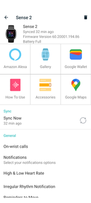

Just so there is no confusion, Google Pay and Google Wallet are two different things (I know, Google made it nice and confusing). To my knowledge, The Sense 2 only works with Google Wallet.
You'll need to have Google Wallet setup on your phone first, then setup through the Fitbit App. Once Google Wallet is setup on your phone, in the Fitbit App tap on the upper left corner of the app, where it shows battery percentage. Then, tap on your device. It will take you to a screen that looks like the attached image. Is there a square that says "Google Wallet"?
