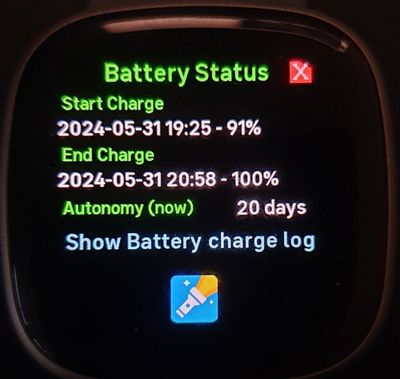

Hi @LSQ - thanks for posting your analysis - see How to resolve the Major issues causing short battery life. where SpO2 is mentioned specifically, though things have improved since then and it is rarely a problem.
I have been running the similar Versa 4 watch in total standalone mode for some days with SpO2 enabled and surprisingly get an indicated 20 days battery life [current level is 85% since that charge].
Worn normally I can get anything up to 14 days using SpO2 and haven't experienced any issues in not getting the results, so it is working, but am using the older V3 Fitbit App.
This is to indicate that there may be a more serious watch problem for you.
What were the results of your standalone test with SpO2?
It would be interesting also to indicate what firmware level you are running, if different from 194.86.

@LSQ - using the watch in standalone mode to verify if it has a fault is only a way to confirm the watch has a fault or not.
In your case it almost certainly has a fault and a good way to verify it is to get a refurbished replacement under warranty (or simply get a refund if you are not happy).
On a new watch with the default set-up without using any GPS you should get around the 6+ days.
