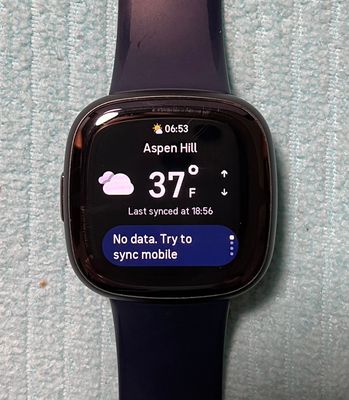

This photo shows very typical Sense 2 Weather app behavior.
I wake up to images like this every morning. The app will update if I force quit the app, then reopen it. But I shouldn't need to do that. Just like the OP's experience, the weather information is updated 40 minutes ago. Or some other old number. I've used the weather app on four other smartwatches and two trackers and have never had this problem.

02-03-2023 05:47 - edited 02-03-2023 05:58
@LZeeW- the weather app on the Sense 2 and Versa 4 is evidently a new development and not the same app and functionality as the app for the other models. Nor is the functionality the same across Fitbit App versions and OSe [iOS & Android]
EG. Android 3.51.1 installed and connected shows
Android 3.74 after login it shows
02-03-2023 06:28
02-03-2023 06:28

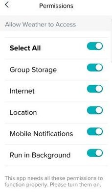

@LZeeW this looks like you may have disabled "Run in background" permission (so you need to launch app in the foreground to update weather app). However, as far as I remember, you are iOS user and things may be different on that platform (which we experienced many times so that wouldn't be a surprise). When I had a problem with Weather app I found out some permissions were disabled why others were enabled (totally random set) and selecting all solved the problem. Saying that, I still have issues with delayed (sometimes many hours) sleep and readiness data so there may be a bigger issue when syncing certain types of data.

@t.parker Up until an hour ago, I had all my permissions set. All of the necessary iPhone setting were correct. My Fitbit app is always running in the background. My Fitbit app was synced six minutes before I took that photo.
I say up until an hour ago, because I decided to uninstall the Weather app.

@LZeeW- It should be noted that on a Sense there is a Weather system function and a Weather app, whilst on a Sense 2/Versa 4 there are no apps so it is just a system function which probably has a bug in some or all of the iOS versions which can manifest itself in different ways.
