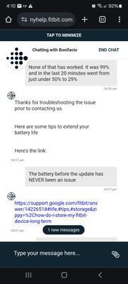

Fitbit app said my device needed to be updated, so I did and now after being fully charged it will complete die within hours. It's on the DIM SCREEN setting, I only wear it, nothing else special, and check texts but I've only received maybe 5 and on a weekday could have 16 and that never drained my battery. This all started with the update and for as much as premium costs, this shouldn't be happening. I've done ALL of the typical troubleshooting on my own AND talked with chat and they said "Here are tips to save your battery" which I already do ALL of them. This is a joke, and they don't care because most are out of warranty. The firmware update caused ALL BATTERY PROBLEMS so FIX IT

The battery was charging and I do know how to check that, which is why I know my battery went from 99% to under 50% within and hour then 20 minutes go by while waiting forever for a chat customer service person to help me it went down to 29%
I had my device just in the last half hour charged to 100% and its gone down to 80% already. I don't use any battery draining setting and know all the troubleshooting which was confirmed in the chat feature which also did not solve my problem. It's the firmware update, which the app prompted me to update yesterday and now the battery has been a joke every since.

Haven't noticed any heat when charging and while it's supposed to be waterproof to a certain point, I don't get it wet ever. This all LITERALLY started yesterday after the app said there was a firmware update. The chat person was fully unhelpful and their email response was my device is out of warranty, that's it. The firmware literally caused the issue and I asked for it to be removed, factory reset and nothing has fixed it.
